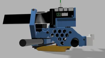

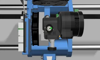

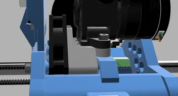

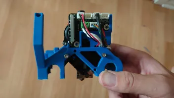

  • First Icarus design with a 4010 fan is complete but not tested, unfortunately I'm out of 4010 fans :D
    I did not want to stray away from the lightweightness (is that a word?) so the fan is still mounted inside the carriage but with a twist (fan is angled so it fits, barely). So the carriage is a bit different and so does is the hotend mount. The other parts for the mod are the same. I guess this will be Icarus 1.1 with the option of 3010 or 4010 fans. I'll upload after my test print.
    I'll show some quick still images.

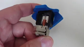

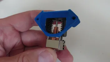

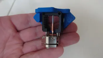

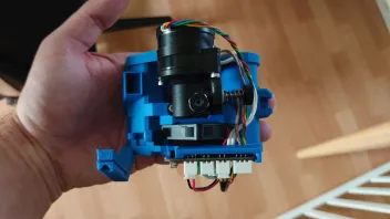

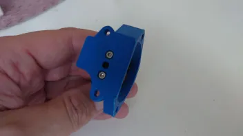

  • Here's Icarus v1.1 (not released, in testing now) with a Sunon Maglev 4010 fan. The carriage is opened up more than the previous version and the fan is closer to the hotend.
    The carriage has mounting options for both 3010 and 4010 fans with a Dragon hotend mount for each.
    About 75% of the 4010 fan airflow is directed to the heatsink while the rest is directed above at the extruder. As you can see in the picture of the 4010 mount, the opening is quite wide so some air flows outside the heatsink but I'm confident it is more than sufficient with a good fan. It is very silent.
    The 3010 fan is so small that all of the air goes to the heatsink. It is quite loud but efficient.

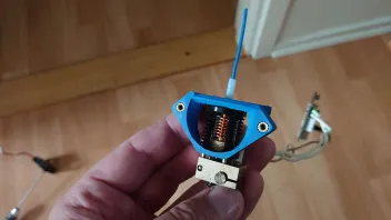

  • Hey guys just a quick update. I made a micro update on 1.1 late last night, allowing for a Mosquito (or Mellow NF Crazy clone) hotend to be mounted. If you've printed the earlier version of 1.1 and want to use Mosquito you can just sand the tabs on the carriage that's holding the mount a few mm and it will drop in nicely.
    The NF Crazy clone seems to have disappeared from Aliexpress since I ordered it, too bad since it was quite a bit cheaper than Dragon, also with very high machining quality of the parts. For those of you in Europe you can buy the clone from vonwange (it's called "DIY hotend").
    The Mosquito heatsink is rectangular, a bit wider and the hotend total height is also a little bit taller than Dragon so I've designed a new Mosquito mount. Will upload after testing it.

    Important! I made a small error in the last version of the Dragon mount which was uploaded yesterday, causing the filament opening to be slightly off center. If you printed icarus-dragon-mount-1.11.stl then you should immediately print version 1.12 since it can cause the filament to bind and in worst case clog. Please print this file to fix it:
    icarus-dragon-mount-1.12.stl
    If you don't want to reprint it at this moment you can instead remove the mount and drill the opening a little larger (5.0 mm drill).
    Sorry for the inconvenience.
